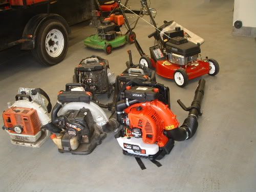

                  Jack D. has several 8000's. He has had some problems w/the choke levers, however these are first production run units and problems were expected.
                  Jack D. leaves his 8000's at the shop when the weather is above 100 degrees as the new Enviro Nut friendly 8000's do not perform well in extreme heat.
                    Jackie - your quite the show off arent you? Do you even mow or do you just sit in your garage all day with your precious equipment?
                      Jack D. does not leave the air conditioning when the temps are above 100 degrees. He will either relax in his air conditioed shop or run important errands in his air conditioned truck.
                      Thank you for your concern.
